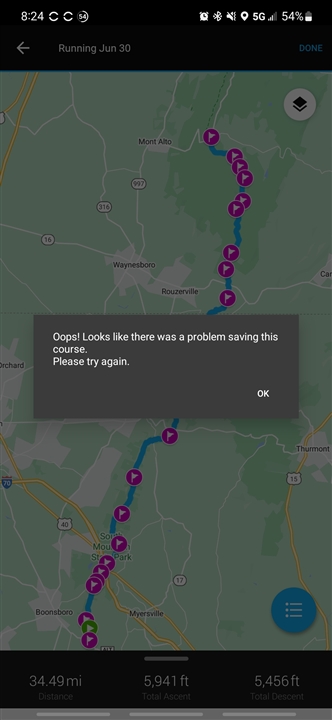

After the latest update, importing GPX routes from Gaia or other sources no longer works. I am thru hiking the Appalachian Trail, and have been relying on this feature daily for the past 3 months, and…

I've had same issue - couldn't save an imported GPX file on the Connect app. This is the workaround I figured out until the bug is fixed.
1) Convert the GPX file to…

It definitely looks an issue with Garmin - the Connect app can load the files perfectly well and interpret the waypoints correctly but breaks when it tries to save. Connect web can load _and_ save the files correctly.
It looks like the app will not save waypoints that look like this:
<wpt lat="51.7615860" lon="-0.7443150"/>
or this:
<wpt lat="51.759468" lon="-0.74298099999999"></wpt>
but is fine if you add extra elements in:
<ele>0.0</ele>
<name>Point</name>
<type>GENERIC</type>
</wpt>
Those elements are NOT required but the GPX spec but for some reason Garmin requires them :shrug:
