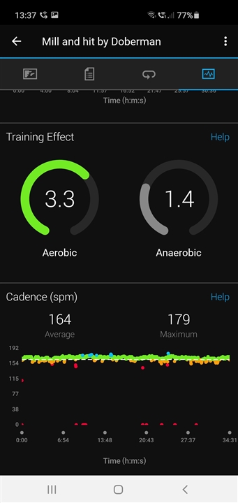

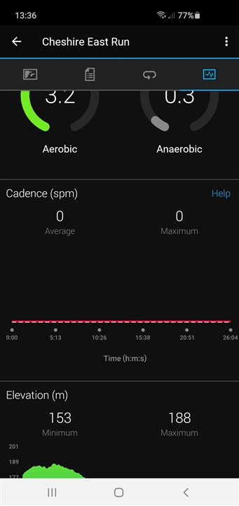

Forerunner 935 cadence recording stopped recording. Does anyone know why or how to correct it

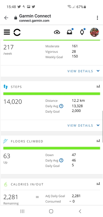

  • Please post a screenshot of exactly the page I linked in my previous post. This one is again not helpful for the analysis
  • Well, that's already on the right page, but still not showing the daily Steps progress graph. Please scroll down on that page, a make a screeshot of the Steps block (especially the graph).
  • OK, that's it. It all looks all right. The accelerometer detecting the steps worked, and the steps were counted even during the activity. The last activity misses all Cadence data, and also the Total Moving Time, already in the original FIT file. The firmware version of the device is identical to the one used at the older activity, so the problem apparently is not caused by a firmware update. Garmin Connect does not play any role in it (as I wrote, already the source data from the device are missing the cadence), so the version of GC app is not the culprit either.
