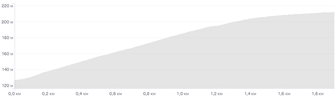

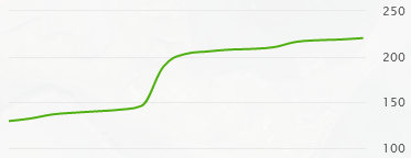

2. Altitude graph does not have a scale to a selected part of the route. Which makes not possible to be sure that you start the segment exactly at the beginning of the climb and finish the segment at the end of the climb and vice versa.
3. Altitude profile of just created segment does not have anything with a reality.
