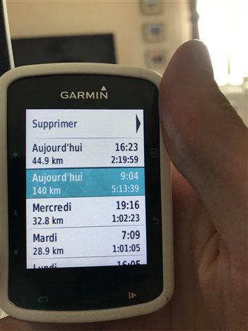

    As you can see, my ride was "well" recorded:
    The problem came when trying to upload my activity: corrupt file!

    regarding the screenshot
    the data you see in there for your ride is totally indepentent of the data in the fit files
    and
    the fit file from your last post contains no data at all (only small part of the file header)
    so, time for a backup/clean operation on the ACIVITIES fodler
