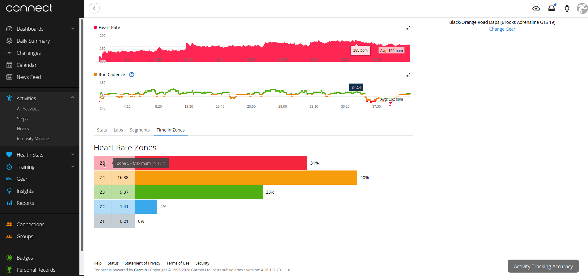

  • Running activityWalking Activity
    screenshots attached with mouse pointer hovering over Z5
    These are outdoor activities tracked with my Garmin FR35.

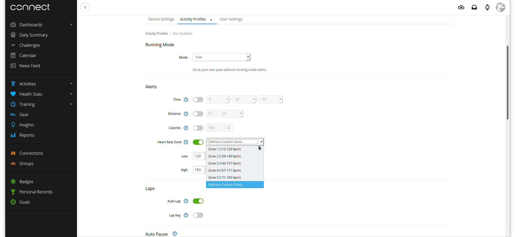

  • OK - I changed to the setting in connect web to "% of max", synced to my device,
    device settings after change

  • Hm, to me your time in zones look ok. Track beginning and end of each zone in your HR graph and the minutes spend in there match the percentage shown:
    Zone 3 (140-156): 0:27-0:36 = 9' = 22 % of 40' total

  • Yes, Ollypsilon, duration in each zone is consistent with the zones being used, it's the definition of the zone that is the problem. Zone 3 should be 152-166, according to the device settings I have configured. (see first screenshot above)

    Interestingly, however, on the "activity profiles" tab of the "Device Settings" page it is possible to configure an alert for HR Zone for different activities, and the pre-configured zones for these alerts reflect the numbers I am seeing on the "time in zones" graph, i.e. for Running (out and indoor) the default HR Zones for my age are shown, but for walking and cycling the zones I have configured manually are used.
