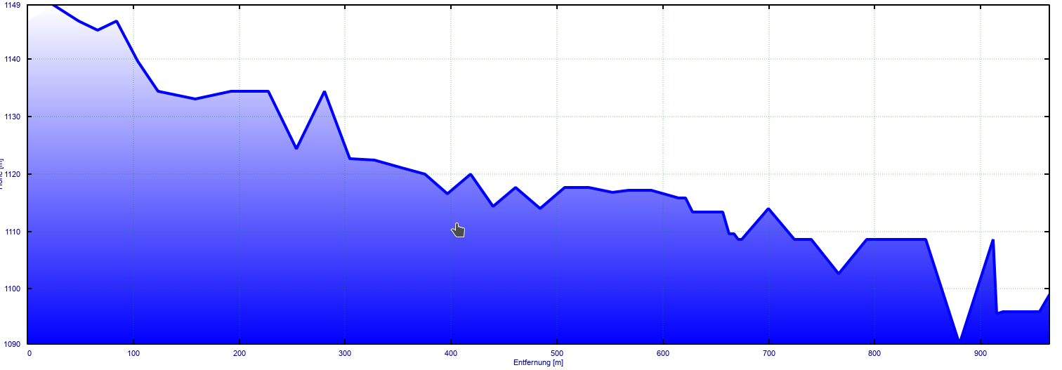

Interestingly, the shape of both track from step 5 and 6 seems to remain intact, eg. elevation of individual points is still plausible.However: when zooming into the elevation profile, the reason for the way off indications becomes visual: the original .gpx shows a very smooth profile, whilst the data received from Garmin Connect adds a significant "jitter". This jitter simply adds up tot a total, that is way off.
I added screenshots of elevation profile of the original track, downloaded .fit file without and with enabled elevation correction. The segment from the track is the same (km 60), I tried to give the same scaling of the y axis.

Robert ciq.forums.garmin.com/.../1439164.png ciq.forums.garmin.com/.../1439165.png ciq.forums.garmin.com/.../1439166.png
