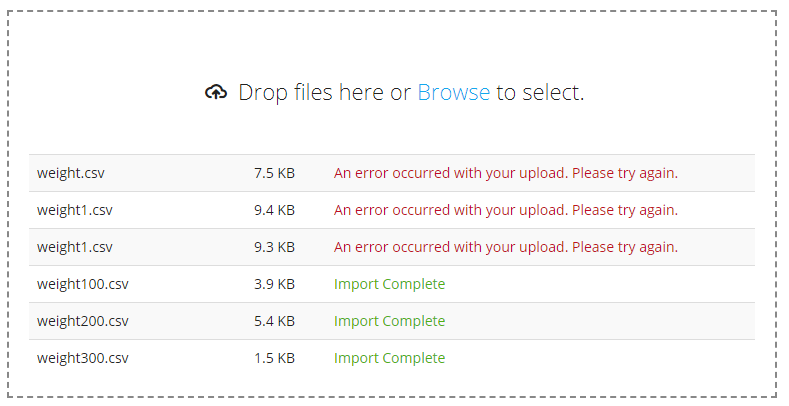

  • Thanks to greenawayj for post #36 I was able to clean my withings data and get the process started. It continued to fail with no progress until I used backdoc suggestion of adding the Body line. Then I could get the import to start, but not complete. So then I added the quotation marks (good thing I know regex, which made that easier!). Still failed at the end of the import.
    So then I despite the file being under 10kb, since it had 240+ records back to 2009, I broke it into three separate 100 record files and was able to successfully import!
    Thanks to all for the help... ironically, I got a reply from product support stating "this is something we have never supported" bwahahahaha
