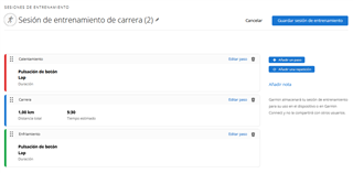

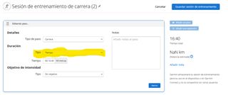

    In my case, trying to create a run training of type Time. An easy example to reproduce the issue:
    1) Create a run session
    2) Delete the warm-up and the cooling lap
    3) Edit the run lap and make it of type "Time"
    Is not possible to register 'cause a failure system....

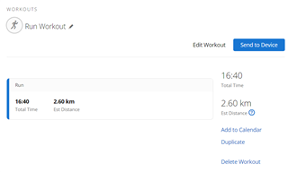

  • I just tested it in exactly this order. I could save the workout without any error (see below), so it does not seem to be a global problem. Can you post the exact wording of the error you are getting?
    Then, trying to save, is not possible to register 'cause a failure system....
    Its not the only combination where you can achieve the issue. The problem is only generated in the web app, 'cause if I try to do it by the clock I dont have any problem.

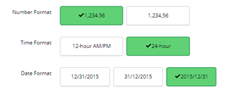

  • Yes, that's exactly what I did too, and got no error. Try changing the number formats in User Settings of Garmin Connect, perhaps it helps. I have them in the way shown below. I suspect the first one, could be the culprit:

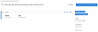

  • Thats correct
    If I change the Settings > Number format: "1,234.56" the training session can be created correctly.
    I think there's a Bug calculating the estimated distance in some trainings with the number format "1.234,56"
