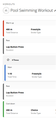

  • I did not test it, but what about using a Workout with 4 repetitions of a step with 1:10 time target? Something in the following way:
    You could also do it 8×35s step or 16×17.5s (depending on the pool length), in order to have the beep at (or near) each turn

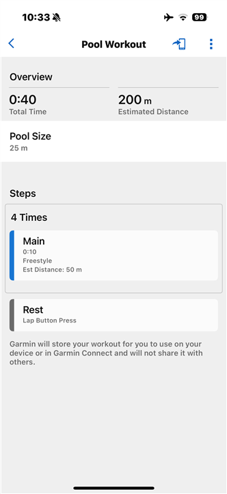

  • Thanks, set this (just 10sec test) but need to hit the lap button every interval or doesn't buzz. Any ideas?
    i
  • Thanks, I set the below with 10sec interval just to test but need to push the lap button each interval or doesn't buzz any ideas?
  • Yes, I just tried it too, you are right. I am afraid you cannot change the behavior. Another possibility would be using the "Custom" type of workout. You would have to select another sport (for example Snorkel, or another one from the category Other) for recording the swim, and then changing it to Pool Swim later in Garmin Connect. You'd still miss some of the swim-specific metrics though.
    And you can also just use the standard Timer set to 1:10 with the Auto-Repeat option enabled.
