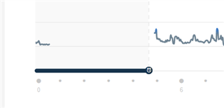

The Connect app Beta heart rate graph shows a 4 hour heart rate gap ( no data) during last night's sleep. However, the data is present on my Viviactive 5's heart rate graph. I have re-synced and the data is still missing.
Anyone else experience this Beta Connect app issue?

  • Hi, is your problem resolved? I have the same problem since last midnight.. I’ve reinstalled the app and reconnected the watch three times. But from midnight until 5 in the morning my hr and body battery and stress graph is showing gaps. Now it’s syncing normally again. I’ve also tried syncing with express, but the data is still missing.
    I also have a vivoactive 5 and it’s 3 weeks old, I’m not on beta though  and my connect web data is also missing, on my watch nothing is missing.
    Oh and my watch did not reboot or something. I was still awake when the gap shows. My data on the watch does not show gaps in the hr graph like it would do after rebooting.

    ive just looked back into my graphs since I have the watch, which is only 3 weeks, and I noticed I have missed data starting at midnight 5 times more. I hadn’t noticed yet, because it’s exactly at midnight that it is missing and then it mostly picks up again within 30-45 minutes. So it’s hard to see the missing hr line because it’s at the start of the graph. On connect web or when changing phone orientation it’s easier to see.
    I will report this tomorrow to Garmin. Because I find it odd it’s sometimes apparently missing data when a new day starts.
