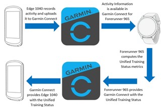

  • I do not own an Edge computer, so am unsure whether it really works as designed, but it is supposed to work in the way shown on the following diagram from the document What is Unified Training Status? | Garmin Customer Support:
    It means, you have to sync the devices several times, before they completely exchange the data over the Unified Training Status through Garmin Connect. First of all you have to sync the Edge, then you have to sync the watch, then you have to wait a few minutes (? they do not tell how long it takes the watch to reprocess all the data, but I suspect it could be up to several minutes), then you have to sync the watch again, and finally you have to sync the Edge.
  • The training status syncs fine through this process you link to. It's the calories that do not.
  • OK, I see. Sorry, I already forgot what was told in the thread and am lazy to read it all again. But if the active Calories come only from the watch (the Primary Training Device - PTD), even after the multiple syncing, then it looks like the PTD has the priority for the Calories. In that case you could only force it to use the Calories from Edge if you did not wear the watch during the ride, or if you disabled the OHR on it. If it does not help either, then I recommend reporting it to the Support.
