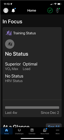

  • I think there might be a broader garmin issue. My training status hasn’t updated in about the same period of time. I run 4+ times a week and get VO2 max updates. I’ve yet to find an answer just people suggesting I’m not meeting the requirements when  nothing in my training habits have changed. @garmin what’s going on? I’d like real answers.

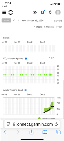

  • Could you post a screenshot of the page https://connect.garmin.com/modern/report/-1/running/last_four_weeks ? It could reveal some hints.
  • I see two problems:
    • There is Training Load data for the last 6 days only. Did you reset the watch, or changes the Primary Wearable Device recently? Or what else did you change the 6 days ago?
    • There is no HRV status - do you wear the watch during sleep?
    The device needs approximately two weeks of training history that include activities with running or cycling VO2 max (or the HRV status, on some models), to determine your training status. So if you wait another week, and continue having the training load data, you will very likely get the status too.

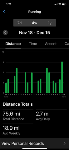

  • No changes with my training. I wear a garmin 245 all the time. I don’t recall if there was a software update, but I’ve made no changes on my end. This other chart in connect shows the training exists.
  • As far as I see, Garmin released a new firmware version for FR245 12 days ago, so that's the most probable reason - possibly the watch was not updated cleanly for some reason, and the Training Load data was reset, and started anew. I am afraid you cannot do much more than waiting around a week, and then the status should reappear.
  • Thanks for looking into this. This sounds plausible. I’ll wait and see if it picks up in a week or so.
