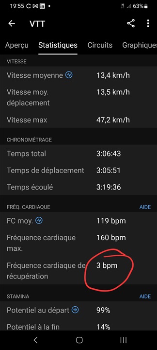

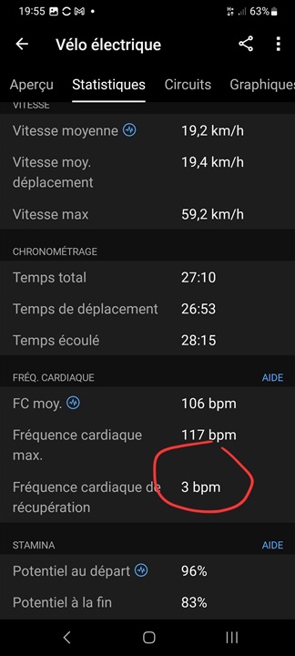

Hello.
Some examples. Any issue on your side.
Fw 16.22, Famous GC 5.0
Wondering if it's being truncated somehow. What does it look like on Garmin Connect Web?
Just checked mine. It's the same. But I don't normally take to time to record my recovery HR.
Tested again, this time after I stopped the activity and before saving, I selected "Recovery HR."
Let it do the 2-minute measuring.
Then got an accurate Recovery (at least based on a 5-minute test activity)
Checked the app and it was the same.
