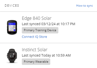

  • I found this which talks about your Primary Training Device (PTD) and your primary wearable, which for me is an Instinct Solar (which does not support Unified Training Status). Why this isn't all computed on the backend is beyond me.
    support.garmin.com/.../
  • Though, I am confused. My Edge is my PTD and HR data is not used, it seems, as suggested. Only my primary wearable is pumping HR data to Connect:

  • I hesitate to wear my watch for fear of conflicts over which one to use data from or even connect to.
    You can wear both simultaneously. Edge will record the activity, and Instinct the daily HR, Calories, and Intensity Minutes. Just the sampling rate and the HR accuracy of Instinct will be worse than from the strap, so I would rather suggest connecting the strap to Instinct too, and starting the activity on it too (discarding instead of saving at the end, to avoid the duplicate).
  • I'm already dual recording with Zwift. I hate to add yet another activity to the mix I have to manage. This just seems like a bug since my Edge is the PTD. My older Instinct is my Primary Wearable and can't be a PTD. I started a chat with support but will have to pick it up later.
  • This just seems like a bug since my Edge is the PTD
    Not a bug. It is designed to work exactly in this way, and it was always so. You can suggest a change to Garmin at Share Ideas | Garmin, but do not keep your hopes too high, and especially do not expect it changes anytime soon.
    Instinct does not need to be the PTD. If you want the HR on the all-day graph then you have only two options - either simply wear the Instinct, or use HRM-Pro or HRM-Fit chest strap - those can be linked directly to the app, and would deliver the daily HR too. And you can use Instinct also without recording any activity. Just the accuracy will be lower, but you will have at least some data.
