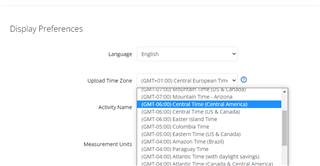

One problem that remains is that the displayed time on any uploaded activity with GPS is still wrong (one hour ahead) so I guess that whatever Garmin server is processing the data does not have an updated TZ map itself? For activities without GPS (like Strength) I get the correct time when I select "Upload Time Zone" to GMT-06:00 Central America (Mexico is technically speaking not Central America but North America) but not when I select GMT-06:00 US & Canada. I can live with this but what is the difference, that DST is most likely active in GMT-06:00 US & Canada at the moment?
