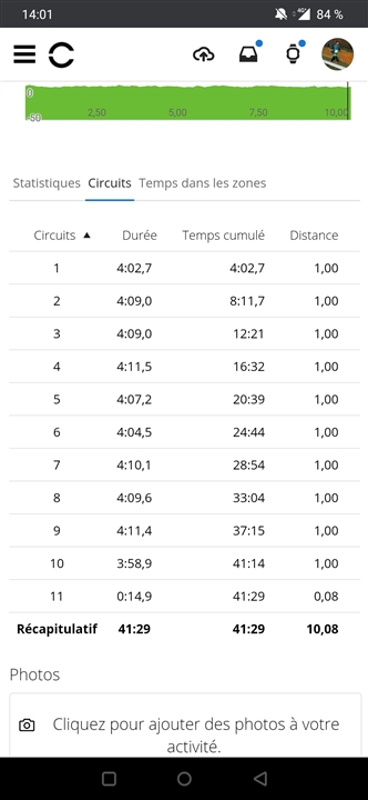

 I wondering about the calculation of personal records,
I did a run of 10,08k in 41'29", so in average of 4,07min/km.
During this run, there no big speed variation except the final sprint at 3,30min/km during 20 second.
In my personal records, I see my records for 10k in 41'28".
If I take the average speed (4,07min/km), my record for 10k is 41'10"
How are personal records calculated?
If you have any explanation...
Thanks

    According to you explanation and my run review(on the picture), I think there is a little bug: the fastest 10k is in 41'14" ( or may be faster but I can't see this without big calculation)
    Do you agree?

  • No, it is not really what the description tells. It just tells that the distance of the activity does not need to match exactly the given record distance (10k), and that manual changes won't have impact. However, normally, the algorithm still searches the best exactly matching section within the activity and proposes it as a PR. I just checked couple of my previous activities with records - for example I had new 1km, 1mile, 5km and 10km records in one activity, and each of the PR respects the fastest section within the run (it was 17km long in fact).
    In my case it seems to work correctly, so I do not quite understand why it did not work in your case. Unless you edited the activity manually, but I do not think you could edit the lap times, unless you imported the run from an external file, which I suppose is not the case.

  • .. thinking about it again, it can be perhaps depending on the watch model - records are (at least partially) managed by the device, so it is possible that it is your watch that calculates the fastest section differently than mine. The fastest sections are then perhaps stored in the fit file, and the GC account just displays them. That's the only explanation I can find, that would explain why the fastest 10km section was not detected in your activity, while it works all right for me. What device do you use? Is it an older model, or a recent one?
  • Former Member
    0 Former Member in reply to trux
    It might be this!
    I use the Forerunner 235 with the last update,
