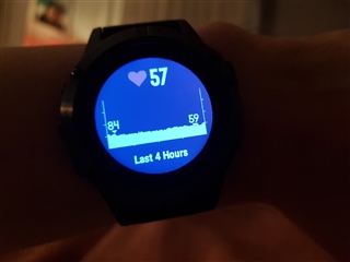

Occasionally my Fenix 5S uploads a "straight line" in the heart rate graph.
In the watch the "last 4 hour" heart rate history will show correctly, yet upon upload, there is a problem, and it is graphed as a straight line.
The attached photos show an upload where it is clear that the heart rate history is in the watch, yet uploads as a straight line.
Things to note:
- heart rate data may upload and show correctly inside an activity in the app, e.g. a run, yet still appear as a straight line in the overall daily heart rate graph
- restarting the watch helps most often for about 12-24 hours, yet randomly starts occuring.
- below photos taken at time of upload to app, 11pm, 25 jan 2020.
Thankful for a solution!
Regards John
