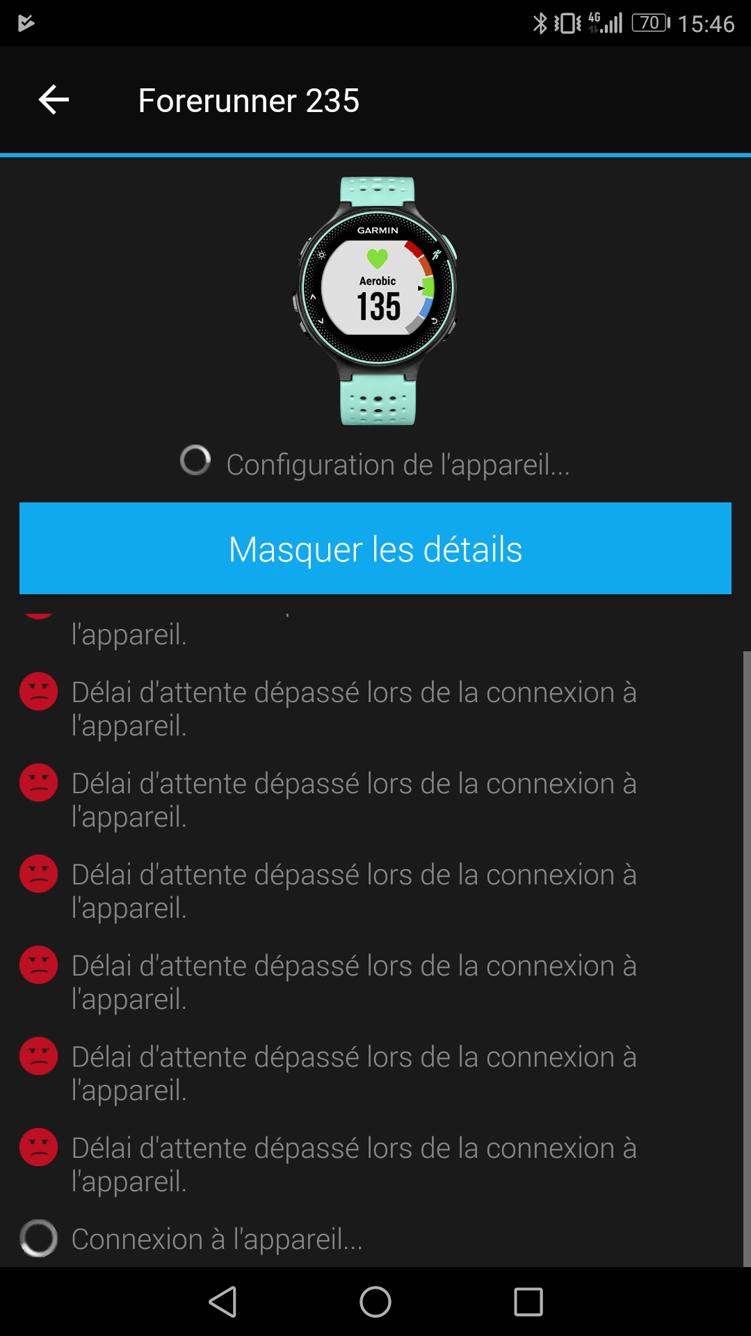

  • I had pairing issue with my Honor but it was running fine more or less since few days. Yesterday it was unable to load my last running session from my FR235 so I said to the Honor to forget the FR235 in order to pairing it again. Big mistake !!!
    Now its absolutly impossible to pair my FR235 again !
    I'm trying since yesterday, it doesnt work.
    When I want to add a new device the Garmin Connect App said in a pop-up : "search for a FR235" then in a new pop-up : "Do you want to pair with FR235 ?" so it means that the App can SEE the FR235 by bluetooth, right ? Then I say "yes" and when I set "show details" I have always the same message : "wait time exceeded while connecting to the device" (or something like that because it's in french...)
    I test the Google Play Service tip as describe in post above but it doesnt work...
    Heeeeeeeeeeeeeelp !!!ciq.forums.garmin.com/.../1297937.png
  • OK, now pairing works again with Google Play Services tip, I made a mistake at first time, thanx for the tip...
