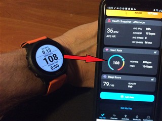

  • Thanks a lot! This app is perfect. Why Garmin wouldn't allow this with their current Garmin Connect app is beyond logic. I understand that they want you to keep buying watches to read the hear rate, but to not provide any way to view live HR and other data on your phone is unacceptable.
  • Why Garmin wouldn't allow this with their current Garmin Connect app is beyond logic.
    Am I not already seeing HR in the app during an activity?
  • This has been a recent addition. Maybe a year or maybe less.
    However, I think you can't keep this screen on as the phone screen will go off after 30 seconds or whatever your screen lockout setting is. You can't use it while running on a treadmill because it keeps switching off.
    All the analysis that Garmin provides, graphs, bar graphs for HR zones etc after the workout is over, can be/should be shown live while you are working out. Will be much more useful. Polar app used to do it five years back, haven't used it recently. Currently there is no concept of a live "workout' on the phone Connect app. Everything is displayed, analyzed after the workout is over.
  • I think you can't keep this screen on as the phone screen will go off after 30 seconds or whatever your screen lockout setting is
    Mine is set to not lockout. I always check that before starting a treadmll run. So, I do see live HR data during my entire activity. Sometimes more than an hour long. Anything else, I can view on the watch, and analyze post-run in the app and Garmin Connect Web. If you want all the other data live on the app, you should request it here - Share Ideas | Garmin
