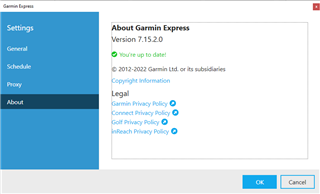

Latest version of Garmin Express (7.15.2.0) refuses to recognize my Tread even though is present in windows explorer and I can navigate all directories etc.
Please correct ASAP!
