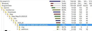

    I've found the folders on the C: drive
    and I've copied Map_Map.EU.2020.20 directly onto the SD card via the SD card slot on my PC so I don't think the SD card is faulty. However, when I put the SD card into the Nuvi it says Map Data Is Not Available
  • Well that's not the map, it's the files used by Express to compile the map file. Run Express again, select under installation options Install to PC for BaseCamp.  If that completes ok follow my instructions above. Note this will only install the map file, and should be regarded as a temporary fix.
