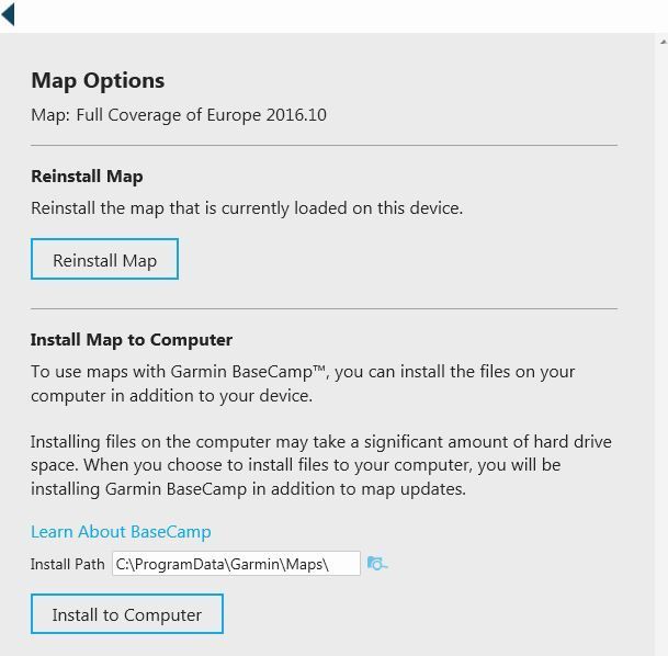

    Well Garmin Express has sure changed, I can no longer find an option to download the gps map to my hard drive. Maybe if a map update were available, it would offer this option. But, I have the latest map + software + there's no map download options offered anywhere.
  • Are you running the latest version of Express? Map options is listed in blue underneath where it tells you which map is installed. At least it does for all 3 of my nuvis.
    Clicking on Map Options takes you here:
