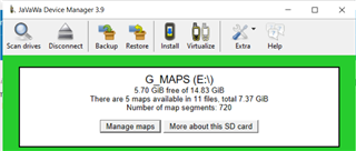

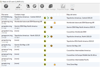

    The JavaWa device manager recognizes the maps as shown in the following 2 screen pictures:

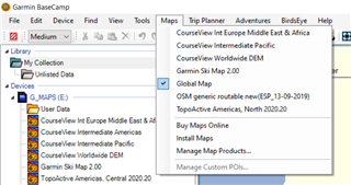

    Basecamp recognizes the maps on the external drive, as seen on the following picture:
    Then, I try to select from Maps in Basecamp, a map from the external drive:
    For example, I choose TopoActive Americas, North 2020.20, and I get the following error:

  • Looking at the list of maps in JaVaWa a number of them aren't showing as being visible in BaseCamp. Use JaVaWa device manager so they are all set to show and see if that helps.

  • You could try downloading the simpler tool JaVaWa IMGname, open the program then drag each .img file onto it in turn and make them visible in BaseCamp.
