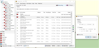

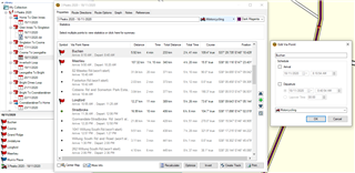

I have an issue with the Arrival and Departure times for via points when included as part of a route. This maybe an understanding issue on my part so any explanation would be appreciated.
I’m using Basecamp 4.6.2 on Windows 10.
I’ve created a trip with Trip Planner covering 9 days. Each day is a separate hub and each hub has one route in it with many waypoints and shaping points.
The issue I have is that when I open the Route Properties window and then the “Edit Via Point” dialog box sometimes the via point has the same Arrival and Departure time and sometimes they are different. In both cases the Arrival and Departure checkboxes are unchecked and the Layover Time is 00:00.
It happens to both waypoints and shaping points. See the images below for some examples.
I've Recalculated the route a number of times, but this does not fix the issue.

Arrival and Departure times are the same.
Arrival and Departure times are different.
