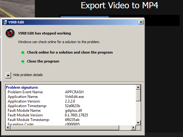

    Today, a cold boot.
    Nothing changed no export no upload.
    Something new:
    When I clicked on export VIRBEdit disappeared from my screen, Crash!
    I noticed that none of the resolutions was selected when this happened.
