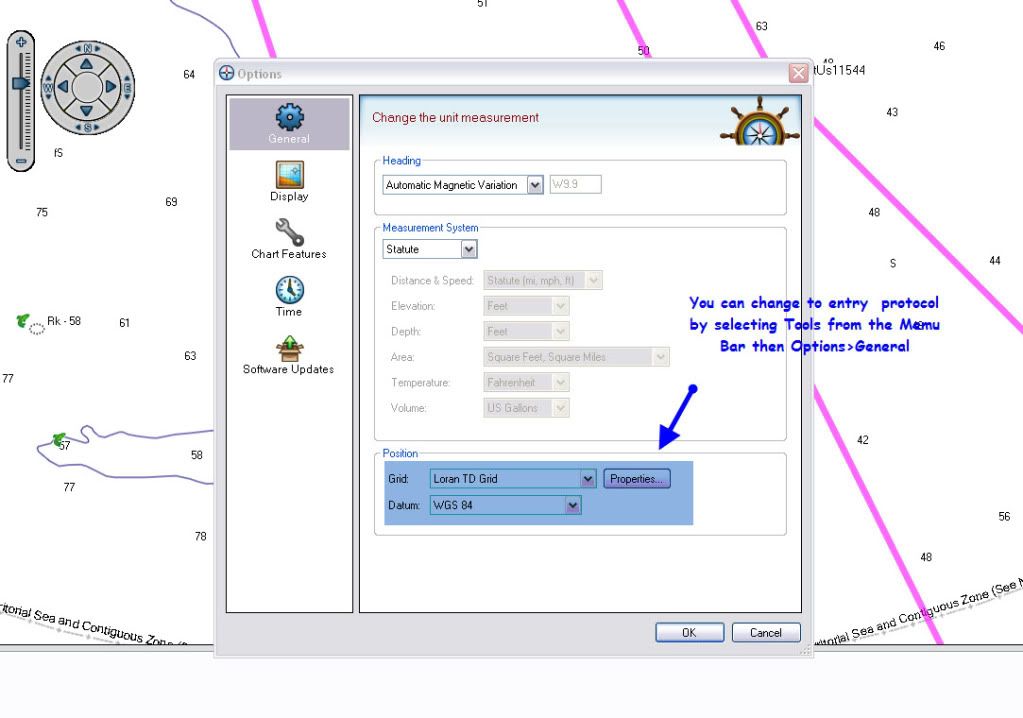

    be sure if you input wpts using
    loran TD's you change you datum to relfect the Loran datum for your area of operation.
    You can find the correct map datum and loran chain information of the paper chart of your area.
    Here's how to change the format to Loran TD's. Remember, when you change to Loran TD's for entering data all your wpt numbers will be Loran TD format. Once you finish entering your Loran numbers you need to change back to lat/long and change your map datum back to the GPS one for your area.
