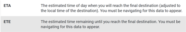

    Also, before somebody from Garmin comes here and says that this is "working as intended"... no, it's not. The Enduro 3 user manual clearly says what these fields should do:
    Nowhere does it say that this is related to the current climb. It's about the final destination of the course that the watch is currently navigating.

  • Good to know. However they have a contradiction. Either the functionality is incorrect, or their manual that describes what this field does.
    Trying to be helpful, I propose this change to the manual of Enduro 3/Fenix 8 and all other watches that use this wonderful logic. (Just to be clear, this following part is a satire to highlight the silliness of saying that this is working as intended.)
    ETA
    The estimated time of day when you will reach the final destination* (adjusted to the local time of the destination). You must be navigating for this data to appear.
    * Unless you use ClimbPro, in which case it displays the time of day until you reach the top of your next or current climb**.
    ** Unless you disable ClimbPro during the activity, then the intended functionality is to freeze the data field on the last prediction and display it until the end of your navigation for maximal confusion.
