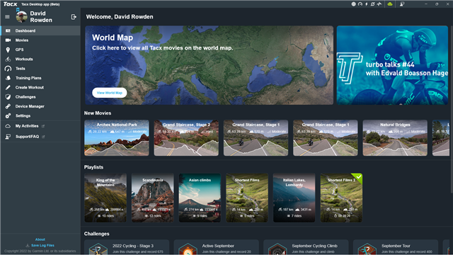

I maybe incorrect but it looks like you need to change the configuration file from Live to Beta.The Beta icon in mine is green and no one is riding the films.
Same here Mike... I have Playlists same as Dave
Dave gets his gold star today. Editing the config file from "live" to "beta" on the first line did the trick. I had forgotten that I had switched out of the beta cloud environment when I was having a connection problem previously and never went back.
Thanks for the tip.
