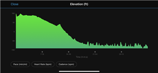

  • Thanks will give a try, are you on the latest firmware/have you done a hard reset of the phone recently?
    This was before elevation correct today:
    And after:
    This is a normal VA3 not a VA3M.
  • I've had exactly the same issue with VA3, Garmin replaced it via RMA as a faulty product. Nothing like this for the two VA3M in the family (my wife has it as well).
    My theory re the VA3 was that during an activity the barometric sensor was inadequately reacting to the temperature rise due to the immediate proximity to the skin, thus reporting increasing pressure / decreasing elevation. I wasn't been able to cure it by either resets or the clean-up of port hole to the sensor.
