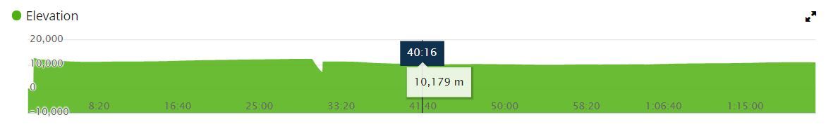

I think I may have found a potential (temporary) solution to the problematic altimeter that we all face (Temporary because software updates should come from Garmin). Please try this out and feedback in this thread if it works for you. If we have enough sample size from everyone that tries out this method, it should give enough reasons for Garmin to do a minor software update to fix this long overdue problem / "bug".
I have tried this method several times and it seems that the elevation data that is reported out by my VA3 is comparable to what I'd get if "Elevation Correction is Enabled" in web version of Garmin Connect.

12. Check the activity in GC. Hopefully, your elevation profile is now correct.

Please try and report back your findings here. Thanks! ciq.forums.garmin.com/.../1471404.jpg ciq.forums.garmin.com/.../1471405.jpg
