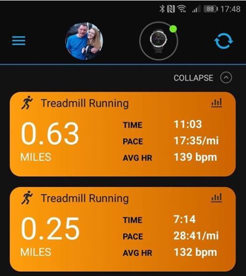

Hi all,
If I use a treadmill at the gym or the hotel, everything is fine with my watch and activity, no issue at all.
If I use the treadmill at home, the watch will stop recording movement after a random amount of time, but obviously the Pace/HR/Time still continue/, just not distance. The result is I can end up recording a 0.5 mile activity that has taken 30 minutes to complete! Clearly not right.
I know I can adjust the activity but I would be roughly guessing distance based on time, but I don't want to do that.
So I'm struggling to work out why in a gym or hotel, the treadmill widget is fine but at home it isn't.
Could it be my treadmill is too close to the wall in the garage? It is the only thing I can think of. I have attached a picture of its location and my Garmin results from some test runs. It was like this before and after the new software release for the VA3 too so don't think it's that.
Cheers all.... ciq.forums.garmin.com/.../1464756.jpg ciq.forums.garmin.com/.../1464757.jpg
