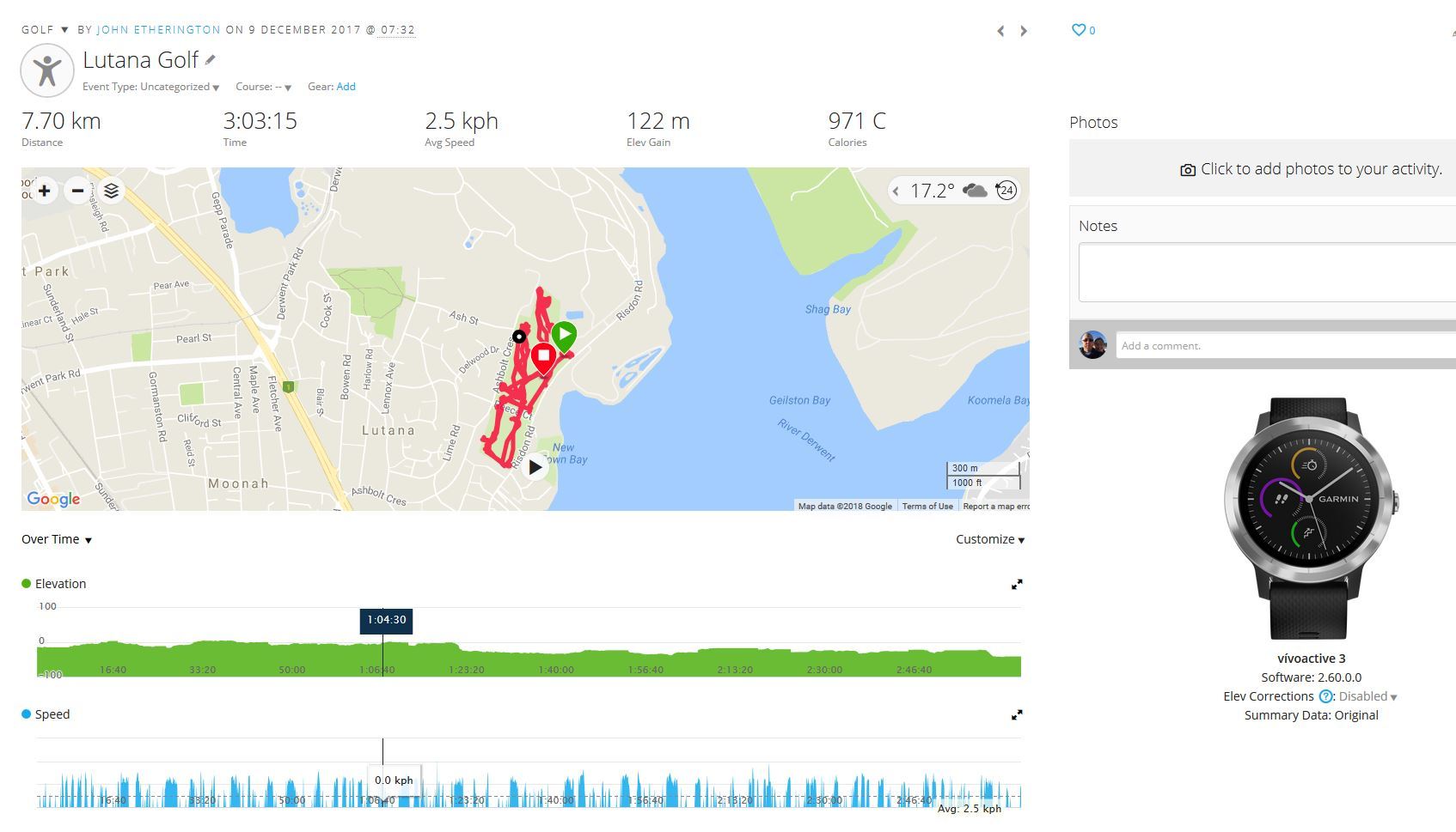

There have been several flaws with the Golf Activity on the VA3 since the 2.70 update and still after numerous support emails sent to Garmin we are now onto FW 3.40 with the same issues.
- Golf activity is not recording GPS information and no map data is being recorded on the Connect app or website.
- After a round of approx. 8km distance walked it shows a 0km distance, 0 elevation gained & 0 avg speed and in turn doesn't count towards intensity minutes when it used to.
- Rounds random exit after a few holes or sometime close to an end of round.
- have had the distance to green lock up and freeze on 257 to green when i am standing on the green, can change it or exiting it without exiting the round and losing the last few holes.
I originally reported this issue in December last year and was told to wait for the next upgrade for a fix.
I originally brought this to play golf with and it cant even do that at the minute ciq.forums.garmin.com/.../1321987.jpg ciq.forums.garmin.com/.../1321988.jpg

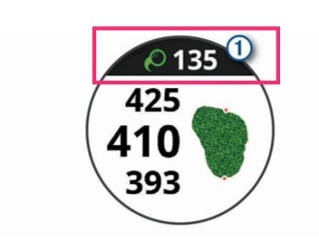

  • Have anyone use FW5.0 can help to confirm that auto shot has correct display as picture?
    This gone for long time ago.ciq.forums.garmin.com/.../1362845.jpg
