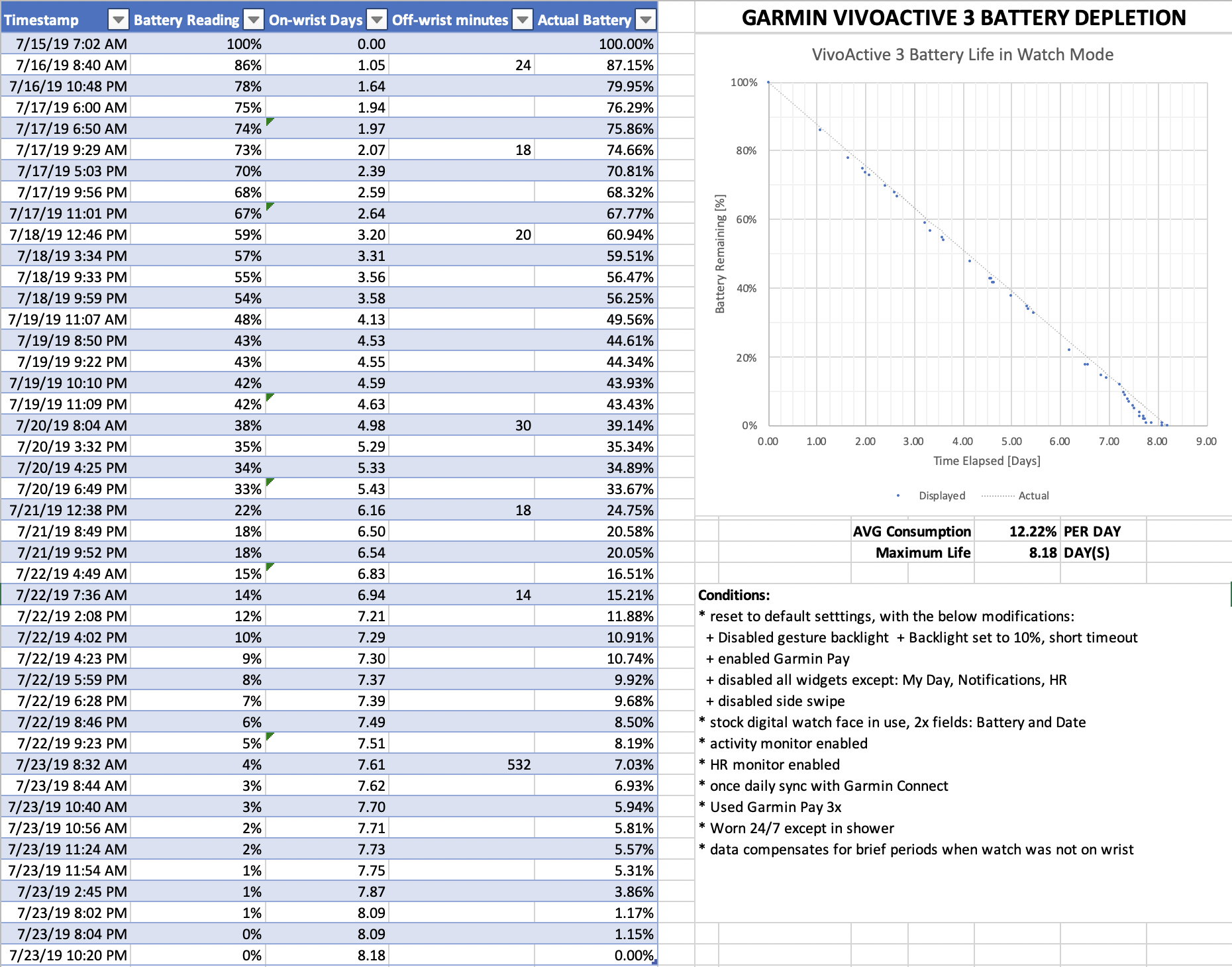

    I've already noticed that 2.70 is draining my battery faster then 2.60. I did a full charge this morning and after 2 hrs of watching a basketball game on TV with Bluetooth off I'm down 5%. At this rate my watch will be dead after 40 hrs of doing nothing but showing the time and HR monitoring. A hard reset was no help.
  • I had exactly the same experience, my battery usage was pretty good on the 2.60 firmware, no GPS activities in the past week as it is pretty cold around here, but the battery was on pace to last the full promised 7 days. Ever since I upgrade to 2.70, it is draining much faster, down to 91% after 4 hours and one non-GPS treadmill run. I also did a full reset power off which lost my accumulated steps etc on the watch but didn't help with the power.

  • Another update from me. Mine was also draining super fast after the 2.70 update, and full power off reset didn't help. I have a battery drain widget installed (3rd party) which was projecting less than a day left of battery life based on the drain rate after a full charge this morning. Funny thing though, the drain rate keeps slowing down to the point where now the same widget projects 3 days left at close to 6 pm, still not the full promised seven days but much better. Sure sounds like some kind of software glitch.
