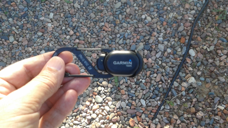

  • runn - the key is to not clip it to your shoe. I picked up an S-Biner from Home Depot (~$2US) and clip it else where. In cooler weather, I just clip it to a jacket zipper for example.ciq.forums.garmin.com/.../1260692.png
