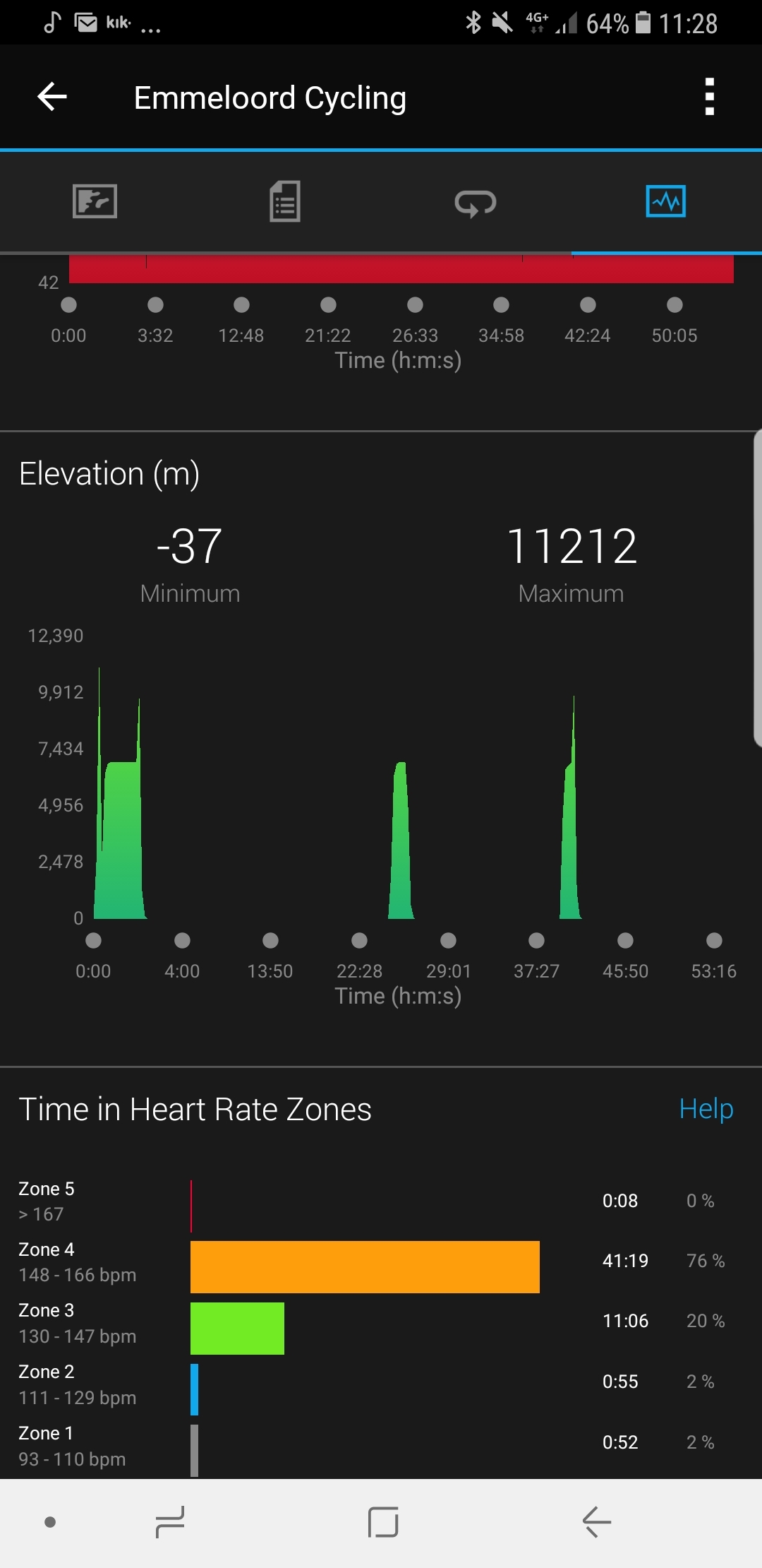

    When looking closer to the info inside Garmin connect it's indeed the speed that is in error ciq.forums.garmin.com/.../1256481.jpg

    It's indeed my cadance and speed sensor. When I disabled those it was ok for distance. Elevation is weird btw as you can see in the screenshot. Trust me I did not have so much elevation lol.
    i do think it's weird it won't work right with my cadence/speed meter. The HR did and the edge 820 does.
    Hope they fix that ciq.forums.garmin.com/.../1257232.jpg
