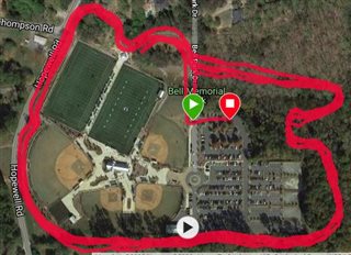

I've had my Venu for about 3 months, and GPS has always been accurate to within a few meters up until late December. Suddenly now I'm getting wonky GPS measurements on all of my runs, which is very irritating as it throws everything off.
For example: here's one from a 4.5 mile run that was so off the mark that it recorded me doing more than 5 miles:

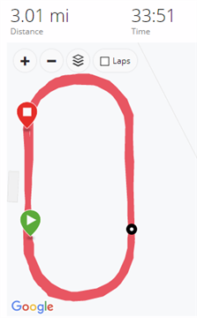

Now here's one from early December where I ran 3 miles, and it kept the laps tight and tracked it right on the money:
Most of my runs have been a lot closer to the 2nd one. Every once in a while it might be a little off, but nothing to the degree that it has been over the past couple of weeks. I haven't made any changes to anything. Anyone have any ideas?

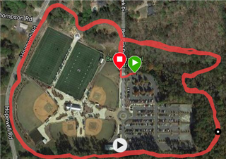

  • In my experience and location GPS alone (left) has better results than GPS+GLONASS (right)
  • Well, no luck. I deleted the folder and switched to just GPS, and the mileage was still way off.
