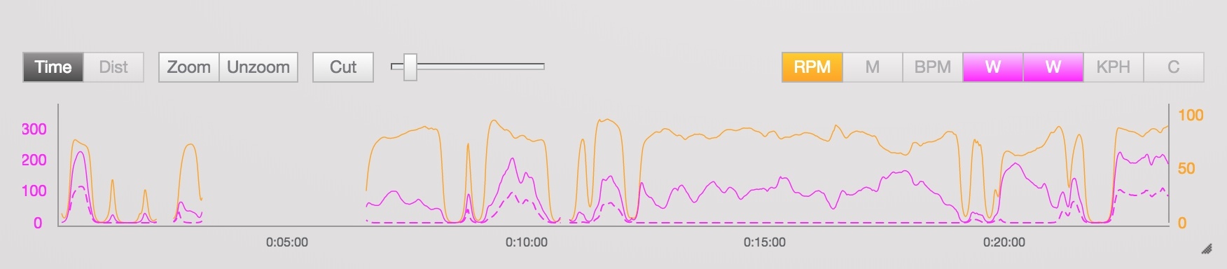

So, headed out for a ride on Saturday morning. On the recommendation of t_smit I rode with my Garmin Edge 510 to gather diagnostic data on potential mishaps with my Vector 3's.
It didn't take long, almost immediately (like in the first minute) the Edge 510 reported 'Right Sensor Missing' (whereas the Bolt never reported anything when things went awry). I stopped, tried a calibrate (that seemed to work before), but the calibrate failed with a '1024' code (which I assume means the right sensor is missing). Turned Bluetooth off on my iPhone in case that was causing problems, but no luck. Still got repeated 'Right Sensor Missing' messages and the power reported was about half what I expected. Power balance was also reporting 100%/0% most of the time.
No amount of fiddling, recalibration attempts (incantations, prayers, curses, etc) could get it going, so I resigned myself to just having to ignore the power data from that ride and kept going.
About 21 minutes into the ride I got a message about 'installation angles' having been set. Given that this was an Edge 510 I can only think that it's a legacy of previous Vector pedals with the pods, but when I got the message the pedals suddenly started reporting power from both pedals and things became normal in terms of power measurement. From then on the pedals worked normally until about 20 minutes from the end of the ride, when I got a 'Low Battery' warning. Given that I have less than 30 hours on the pedals, and Cycling Dynamics is still disabled, that was surprising. I dismissed the message and continued. Later when I checked, the battery levels were good in GCM.
See attached fit file from the ride, along with a screenshot from TrainingPeaks that shows the 'flatlined' right sensor that suddenly wakes up.
I really want to like these pedals. The idea of their transportability and all the additional data is appealing, but first and foremost I need a power meter that I can trust. One that will just work every time I get on my bike. On Saturday afternoon I went to the LBS I got the pedals from. They agreed to take them back if I am unhappy with them. I'm trying to decide what to do ...

  • I don't have a Vector 3, but it reminds me of one of my Vector 2's when one of the pods was going bad. I would lose power from one of the pedals and occasionally it would turn back on and get the 'installation angle' message. It may or may not stay on. I tried cleaning the contacts, changing batteries, etc. Sometimes it would work throughout a ride so I'd think I solved it, but eventually the problem returned. Finally I bought a new pod and the problem went away and never returned.
    Unfortunately, you can change pods, but it does seem a similar problem of losing signal and I wouldn't be surprised if it is that battery issue.

    Sorry... yes, have a look at the right side door. You are getting some resets on that side.

  • The battery status in your file reported 2.59 volts, which is just below the warning threshold. At that point you should still be able to ride for ten or more hours. You should get some new batteries, but it's not imperative (yet) that you change them immediately. The system will shut down and refuse to operate before the batteries get low enough to affect the power measurement accuracy of the system.
    Note that the warning threshold is set to reflect an expected amount (about 10% to 20%) of operating time remaining. The battery chemistry and the voltage vs. capacity-remaining curve dictate that this threshold be set significantly above where one might expect it if a linear interpolation was done between the 'full'
    and 'depleted' voltage values.
