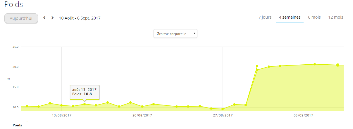

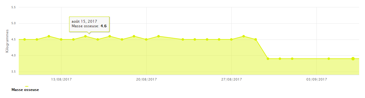

The weight and muscle seem to be accurate but since last week, bone, fat and water seem to be wrong.
The firmware is the 3.0.0
Do someone got this bahaviour? ( see picture in attachment )

    martin.jelle strangely enough I'm experiencing the exact same thing. Scale has been working great for past two months, today my body fat % dropped in half and other metrics were off (weight seemed to be ok). Did a full reset of the scale, nothing changed. Went into Garmin Connect on my phone, changed activity level, saved, then stepped back on scale. Body fat back went back to expected range. Didn't change anything in Garmin Connect then stepped on scale a second time and body fat % dropped in half again. Repeat the process by updating activity level and the scale showed correctly once, then went haywire the second time. If there's an upside it seems like something is wrong with Garmin Connect software rather than the hardware.

    Since two days the Body Fat went down from 16% to 9% and Bone Mass increased from 5.2kg to 5.8kg.
