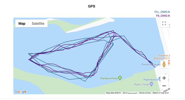

  • Yep have to agree. And to be fair, I too have had some less than average results swimming in small circuits but then others that have been good too. We have a lagoon we swim in occasionally but the course is ˜600m around the three buoys so is bigger than your course. However, as you can see in a straight line with long legs it’s pretty good.
    So a little unfair to suggest everyone avoid Garmin for open water swimming as a blanket statement of fact. What I’d suggest is that people be aware that swimming short courses with multiple turns will possibly to lead to poor outcomes.
    I can also find some pretty dismal tracks that have occurred after some software updates too, but in the main, over the years, the tracks have been more often good than bad. This is one of my less than good swims in the lagoon. Granted it's with F6 and F5+ (people seem to think the GPS tracking is worse than the 935) it's sufficient to demonstrate that it's not too bad even in a closed circuit:

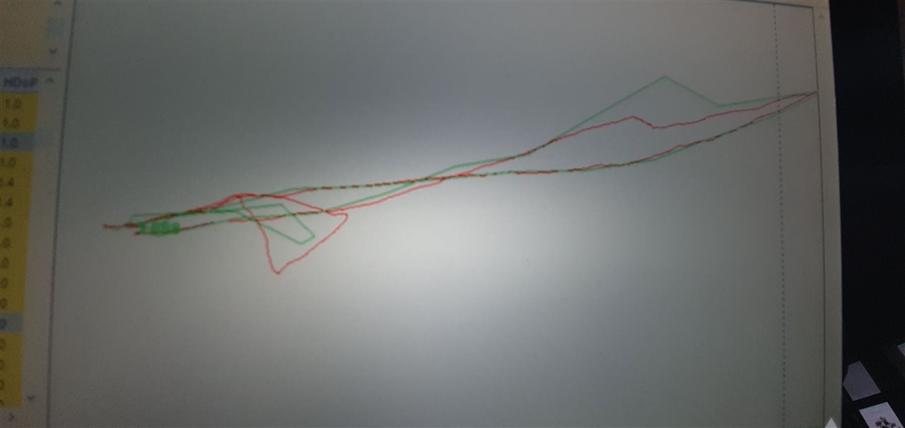

  • Hi again Philip. I note from your posts and some of my tracks that the watches can handle the  straight line "out and  back"  swims which are easy for the processor to ignore missing data points.  However triangle swims with the buoys maybe 100m apart are not so easy and lead to the gps track I posted previously. Let's hope they improve the algorithm or increase the frequency of data sampling and then removal of spikes to improve the accuracy.. enjoy the rest of your season ( why stop for the winter?!)
  •  Green track is  935 forerunner. Red is a highly accurate BGT31 GPS device in my swim buoy. The screen grab really shows how inaccurate the garmins can be when worn on the wrist. They are OK in a straight line but wildly inaccurate when using a triangular course. Each lap of the triangle is 200m. The 935 measured 25% less on each lap.
