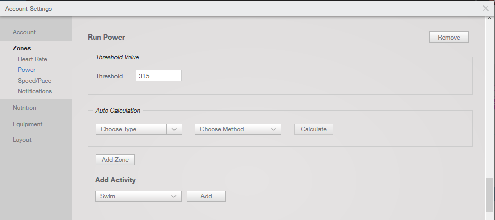

  • ... I could never figure out how to set running power zones separate from my cycling power zones. ...
    Simply configure running power zones or at least running power threshold in TP settings.

    I think if I remember correctly I first tried adding running power as default power and cycling under cycling power but that did't work as default power was also copied to cycling activities. Only after I set separate power for running did it work like in the picture above. You can also add cycling power separately but if you do both activities then it's probably better to set cycling as your default power and add running after that. The foundation of power based training was found first in cycling after all so I think the logic in Training Peaks works based on this assumption... Might also be a bug.
