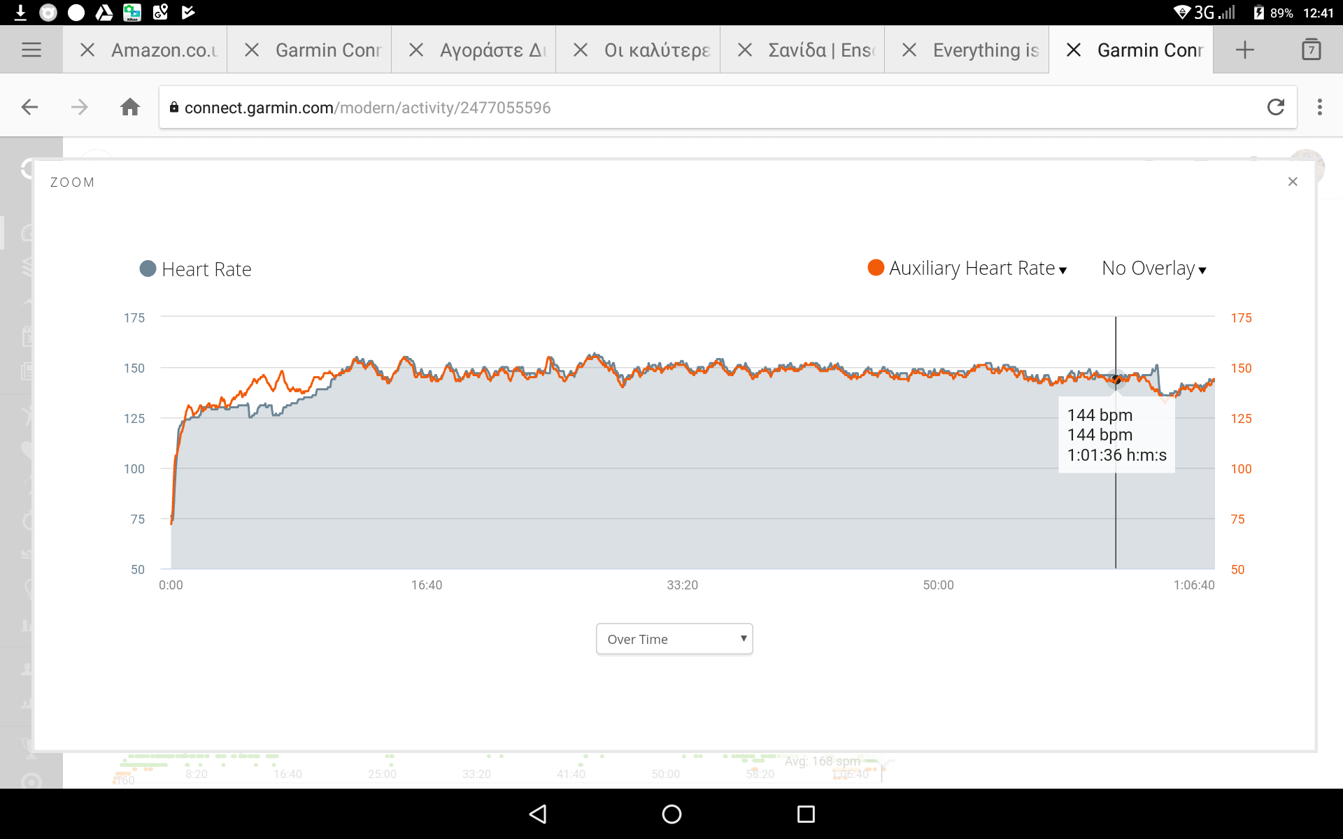

  • Ok, just did the test with the auxiliary heart rate app, the result is below. As you can see the readings are pretty much the same both for the OHRM and the strap HRM, if you exclude a small deviation at the beginning of the workout. But the pace today was easy to moderate, so it remains to do the test again next Friday, on the interval training. If it's the same again, this would mean that OHRM works fine for me.ciq.forums.garmin.com/.../1305112.png
  • Spike,
    Thanks for the update - this suggests that the HR data quality is OK.

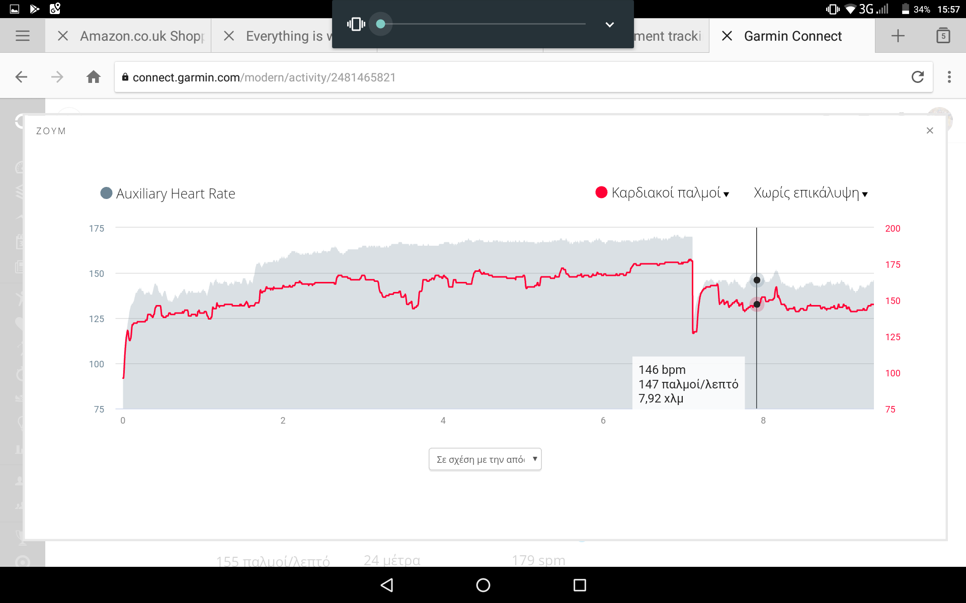

    I have a few questions about this:
    1) What was this workout?
    2) What Chest strap did you use?
    3) That early reporting is not a small deviation, that about 10 mins when the OHRM went walkabout
    4) While in the ballpark for the majority of the workout, the OHRM either under or over compensates (just by eyeballing it)
    5) One test doesn't mean much
    Workout included: (Upper body weight training)--so lots of Muscle Flexion. Used Auxiliary heart rate (Elevate OHRM, HRM-Tri)
    Also, expand the HR data for the OHRM and pull up the Auxiliary as the overlay. In many cases they were upwards to being 60BPM apart (WrOHRM)
    https://connect.garmin.com/modern/activity/2480237750
    Again, one workout means nothing. But time and time again this happens.

    1) Running
    2) An old Garmin HR 7295
    3) If it was so for all the workouts I wouldn't mind. But it isn't as it seems below
    4) it seems to me you're looking for needles in the haystack with this. Again, if the deviation was so minor, a beat up or down (for the majority of the workout as you say, leave the beginning out), I wouldn't mind at all. Heck, if you take two same chest HRMs from the same manufacturer, same model, same batch and all, and put them in the same person, don't expect to have 100% same readings. How do you expect this from two different technologies? And to be devil's advocate here, how do you know it's the OHRM that deviates and not the chest strap? Again, I'm saying, all this would be the case IF the readings were similar for all the workouts, and to be more specific here (sorry that I wasn't before) when I say all the workouts I mean all running sessions, I bought this watch primarily for running and secondly for cycling, definitely NOT for weight training, RIZKNOWS always says it in his reviews, OHRMs are NOT good for weight training,... so if this was the case I wouldn't mind, BUT...
    5) 5.5k tempo today, threshold pace or above, I decided to do the test today instead of Friday's Interval training. It was cold outside today and very humid, it was raining till early morning. Don't know if these conditions affect the OHRM result but the deviation today is more than obvious. I could see it on the watch as well during the workout, I created a screen for both HRMs and the readings were different for the majority of the workout.
    You can see the workouts here :
    https://connect.garmin.com/modern/activity/2477055596 (the previous one)
    https://connect.garmin.com/modern/activity/2481465821. (Today's workout)

    Thank you clarifying, I just wanted to know for context. Which is why I also recorded data and posted for info. A few things:
    The chart is color coded...
    Not trying to be condescending sounding here; but read a bit about the shortcomings of OHRM in general (scroll up for the Valencell write-up I posted). Long story short: Cold weather is bad for OHRM. Not just Garmin, ALL are affected.
    I like RIZKNOWS too, but he's not alone. I think nearly every reviewer ever states this with OHRM.
