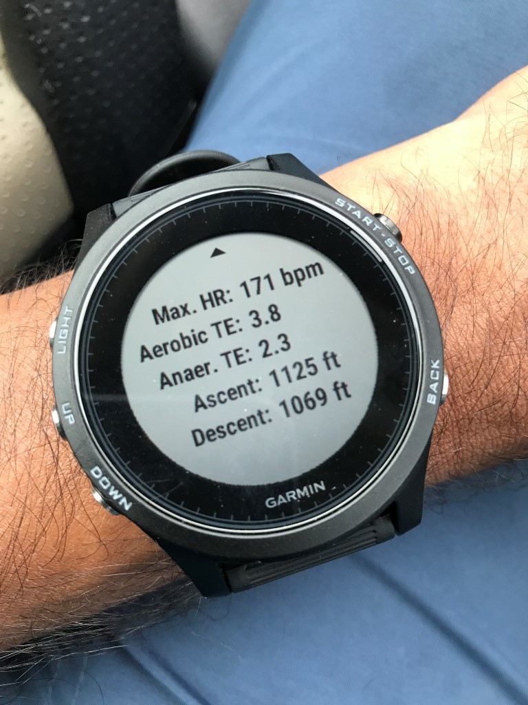

I took it for a hike today. I had a screen with timer, elapsed time, moving time and stopped times just to understand how they work. All of a sudden, it recorded a lap I guess and those fields reset and started counting from that time with a '1' showing next to them possibly indicating it's a lap. I have auto lap set to off. While I am pretty sure I did not accidentally press the 'back' button which I assume would record a new lap [?], I am willing to give it the benefit of doubt and assume I pressed it by mistake. If so, would that change the screen like that?
Even if I did that, why would the timer, elapsed time and moving time fields act as a 'lap time'? At that point, there is no field I can select that will show me how long I have been hiking or how long is the total moving time from the beginning of the hike. Clearly I am not understanding something here.

I have attached pics....
After syncing with garmin connect, there it shows the elapsed time ok as a total of the moving and stopped times.

  • That small '1' is simply 1 hour. Because you have squeezed 4 data fields on one screen there is no room for the full '1:02:45'.
    ah....that makes sense :)
    Thank you for the explanation.
    Anyway, just to make sure, I add a new screen with just two fields and it still showed the elapsed time the same way. So may not be a space issue...may be it always shows that way?
