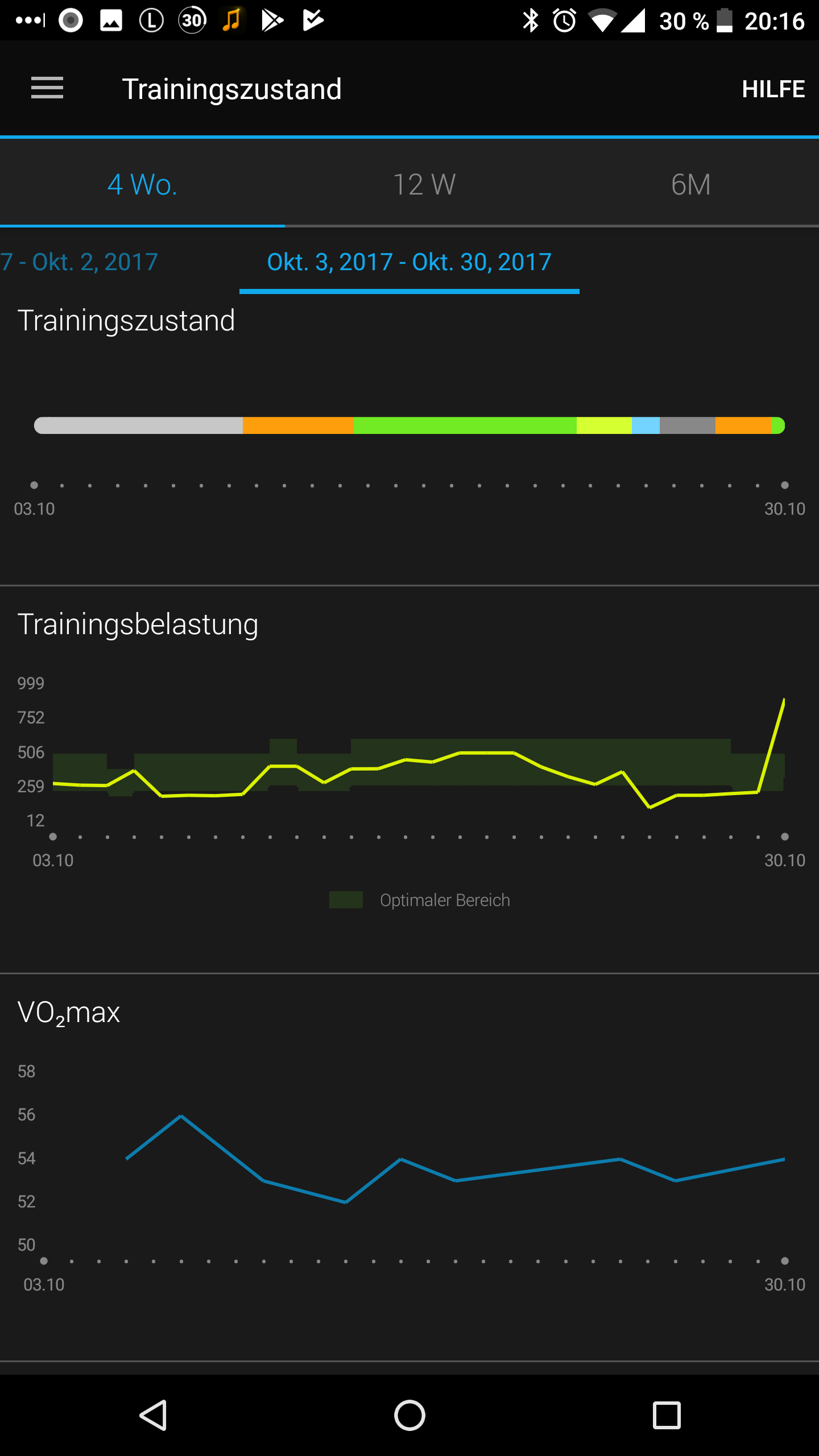

  • I've just seen the same thing, and my max HR is accurate. Training load is at 899 (never had that much even at the peak of my HM training). Have a look at the sudden jump in the attached screenshot. I did a fairly intense (but not all-out) 10k run. Aerobic TE was at 5 with 72 hours recovery. That's what I got after a HM at the same pace! Something seems wonky...ciq.forums.garmin.com/.../1268651.png
  • You can't get any "harder" than a TE of 5.0 which must be why you got a big training load for that one.
    Why you got 5.0 when you felt like it was not flat out is perhaps another question. Do you often get a 5.0 for TE?
