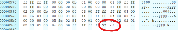

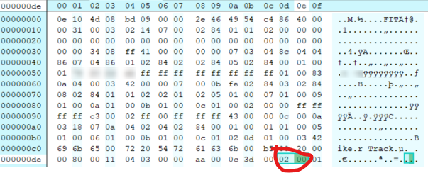

  • I don't think you can do it easily, unfortunately.
    Garmin Connect sets the activity type from values for activity and subactivity encoded in the header of the FIT file for an activity. Those values are set by the activity you pick when you're adding an activity to the start menu. The only way to create something with the right codes which isn't in the list of options is to create or find a ConnectIQ app which writes the codes you want. It makes no difference what you call the activity, that only affects what you see in the start menu on your watch. Weird thing to leave out when they went from 735 to 935.
