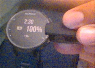

The watch won't boot up even after long press on the light button. But when I plug it into the PC the screen turns ON and shows time and battery percentage (photo attached).

I suspect this issue happened after a SW update in June 2021.
Hi I don't suppose you found a solution as I am having the exact same issue. Thanks
