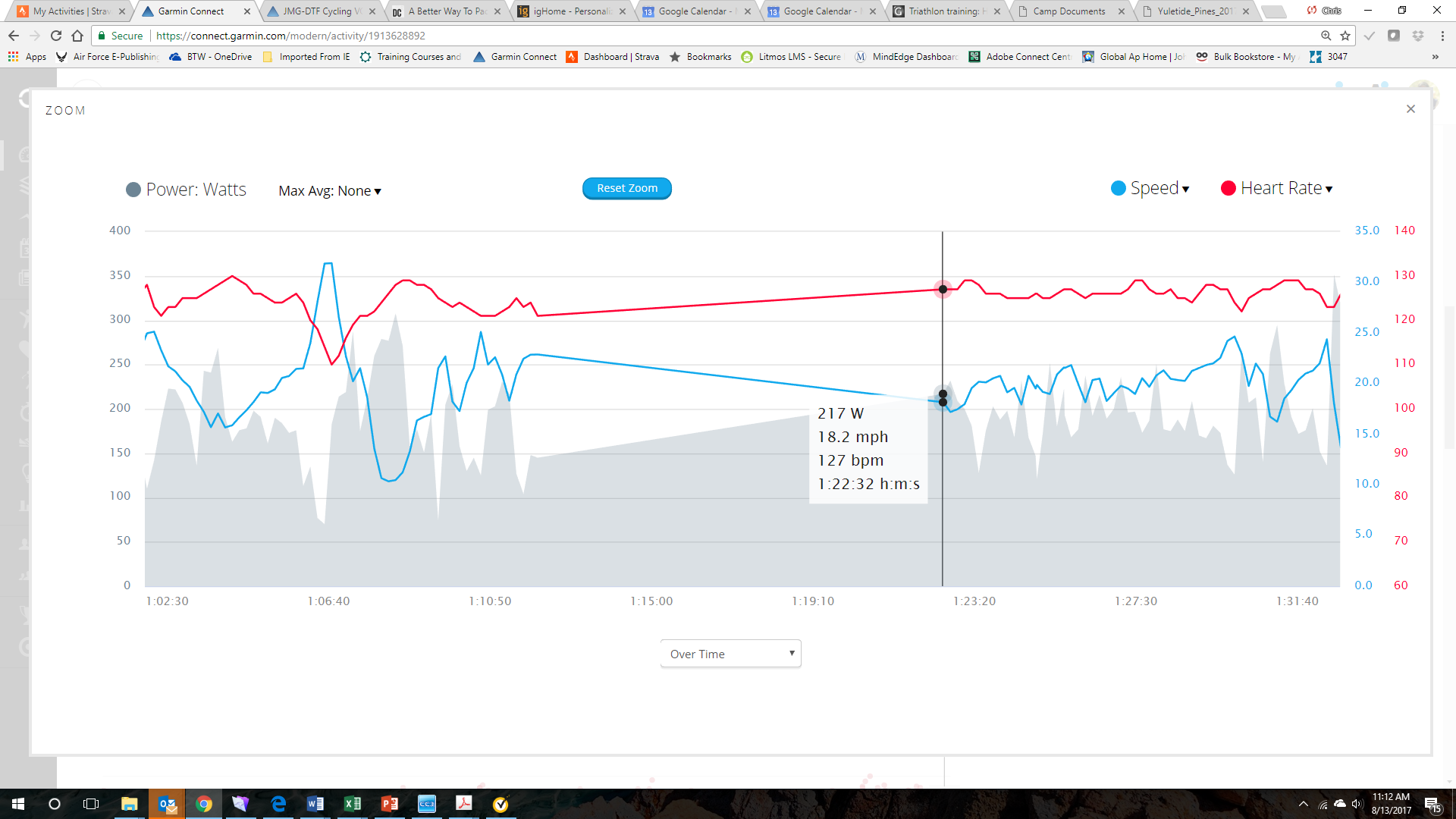

I have a Garmin 735XT. Every now and then (a few times a week), during an activity (swim, bike or run) I'll get an "Updating" message on my watch. During this time, I cannot hit lap (a problem when it happens and I'm ready to start an interval), and I can't seem to get out of it. Usually it self-corrects, often without repercussions. However, sometimes it results in missing data. On today's ride, I lost two miles when the watch auto-updated, and then stopped (requiring me to hit "Resume".

    Yes iIm getting this as well. I can't be sure if its the cause of drop outs but it does seem to tie in with i am seeing.
    In my case, its in a cross race. As I pass the pits, the watch hooks up to my phone which is in my rucksack and then as i pass it drops the Bluetooth connection again. This happens many times a race as you can imagine and i am seeing dropped connections to sensors at the time i am passing the pits.

    I've haven't been able to simulate the data drops, but this might be because the Bluetooth re-connection is always successful.
