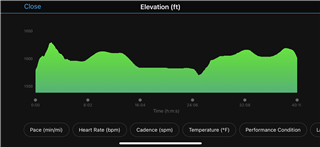

I find when running the elevation data is good initially but then seems to lose accuracy.
See the run below. It is a 40 minute run when I run out for 20 minutes and turn and run back on exactly the same route. The first 20 minutes actually looks pretty good - but as you can see when I return the profile looks totally different and I actually end at a higher elevation than when I started - even though start and finish points are the same.
If I walk this or other similar routes the accuracy looks very good. Any ideas why walking elevation accuracy seems to be better than running?

  • Thanks for the suggestion.
    The run is actually pretty sheltered from the wind - so it is probably not that I think.

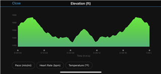

  • Here is a walk in same area. Different route but same principal. Started and walked for 30 minutes and turned and walked back. Here you can see the altitude profile looks like a mirror image from the mid-point - so I think is tracking altitude pretty well.
