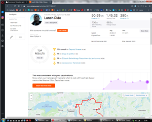

    Ok you can do calibration manually, but when you go a lot higher than lower barometric altimeter goes a bit crazy and elevation gain you get is really not correct. I see it on strava when I press correct elevation with strava data on FR 645 sometimes i get about 150 - 200m ! diffirence when gained 300m of elevation on 50km ride, with Fenix (correction on) there is couple of meters diffirence but this is 100% acceptable.
    Example on 645 :
    what 645 register :
    with strava correction :
    My yesterday bike trip with 2 watches (really not bad when you compare it with that above) :
    Really 645 should get option to disable barometric altimeter on activity or autocorection with gps.
