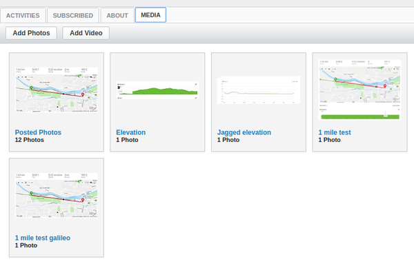

  • jkissane_ how do you manage to attach images?
  • In the Media section of your profile, I add the pics. It took me a while to figure out how as well! You can then click on the 'Select from Photo Album' button & pick the pic that you want to include. It's an incredibly clucky way of doing it compared to other forums I use.ciq.forums.garmin.com/.../1411630.png
  • talsela I think you can just click on fhe camera icon on the upper left hand corner of the post editor.
    If you want to post an image “inline” within the text (with more control over the size and appearance) you would click the A icon, then the “sun and mountains” icon, but then only logged-in people can see it and sometimes the forum rejects it (because of bugs, apparently)ciq.forums.garmin.com/.../1411644.jpg
