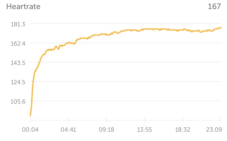

  • I also don’t believe my HR peaked at 191 but it probably wasn’t far off and I can accept that as a optical limitation. Producing garbage in the early stages of a run I can’t accept tho.
  • Attached is my parkrun with a chest strap, they are not so different. Ohr does have limitations but overall your result seems pretty good compared to mine.
  • I think they look very different. Yours smoothly increases whereas mines all over the place then jumps up 20 bpm??

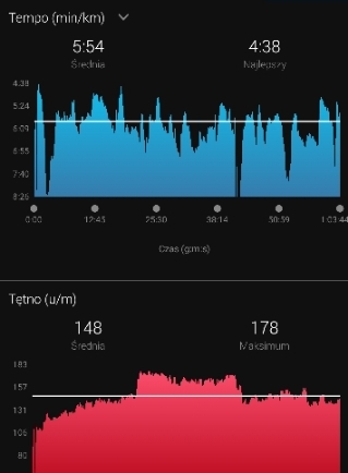

  • The attached is from this morning with the wrist HR. It appears to have worked really well today. I ran at a similar pace for the whole run with no quick speed ups or slow downs.
    Watch was worn snug but not tight.
    I would experiment with watch tightness and position, if it's still giving odd results reach out to Garmin support.
  • Whilst that graph is not as smooth as you’d get with a chest strap at least it looks like you’re getting something reasonably close. I’d be happy with something similar.
